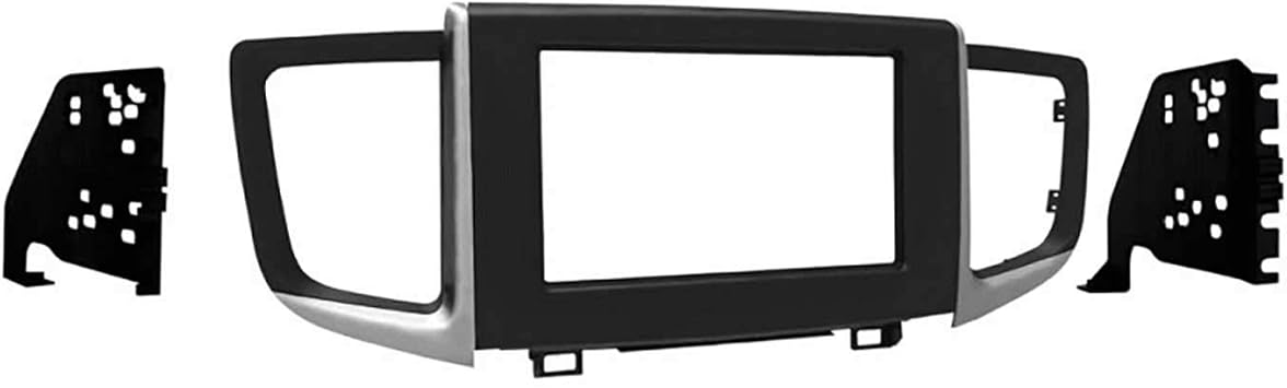

Dash Kit:
Metra 95-7811B Matte Black Double DIN Stereo Dash Kit for 2016-up Honda Pilot
(I like the matte)
I bought this dash kit while Crutchfield and Metra reps wee actually telling me it wouldn't work, but it looks so much the same it was worth paying $20 (it was cheap on Amazon) to try it out. It worked perfectly.

I don't have any pics but I'll tell you that it is a pretty easy install. One thing I really like is that I didn't have to bolt the dash kit back in, so I can pull it out easily any time I might need to get in there.
