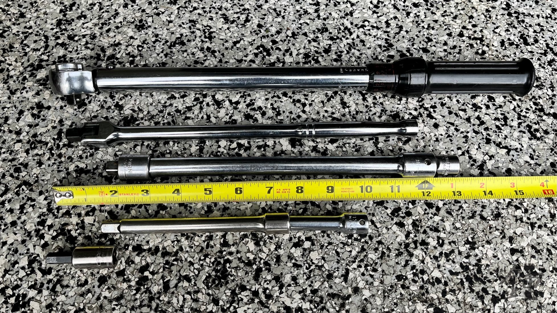

Tools:
  • 8mm hex key (Allen) socket... BE SURE THE HEX KEY IS FULLY SEATED INTO THE HEAD OF THE SCREW PLUG
  • 3/8" breaker bar or ratchet
  • 3/8" torque wrench (35 N-m for transmission plug/screw)
  • 3/8" socket extensions (minimum length with 8mm hex key - 10" for level check, 13" for fill)
  • floor jack & jack stands (as needed)
  • funnel (18" long with 1/2" diameter tip)
  • oil pan (5 quart capacity)
  • infrared temperature gun or other method to monitor transmission temperature fluid (as needed)

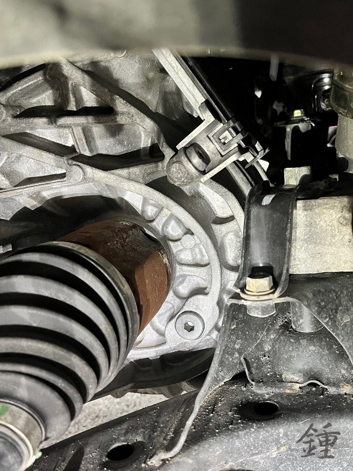

  1. Fill Plug: Loosen this first. Located on the top side with 8mm hex key. Remove the plastic engine cover to facilitate access. A minimum of 13" (8mm hex key & extensions) will clear the top of the engine.

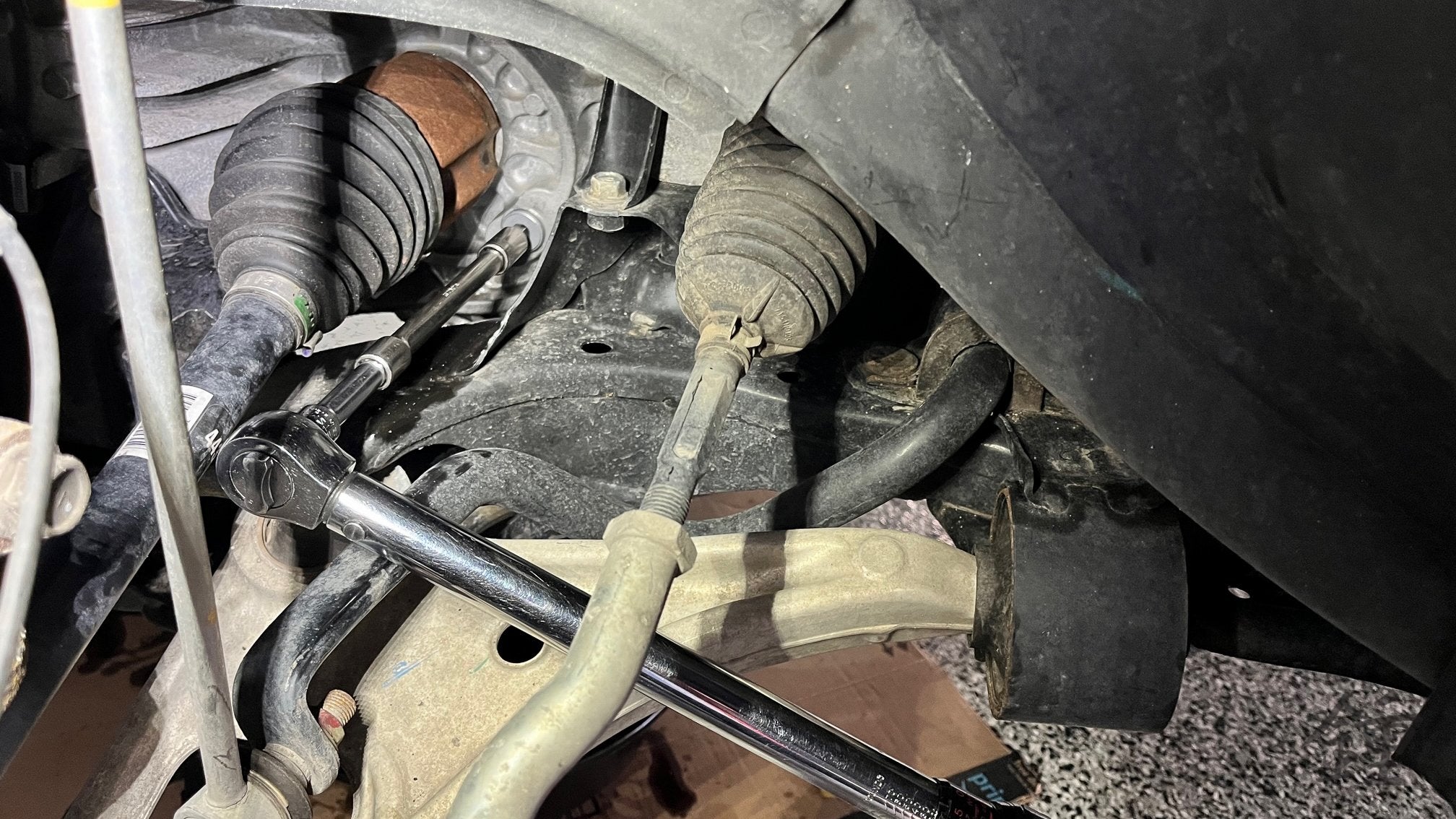

  2. Level Check Plug: Loosen this second. Located on the driver's side (left side) with 8mm hex key. Remove the wheel to facilitate access. Approximately 10" (8mm hex key & extensions) will provide good access.

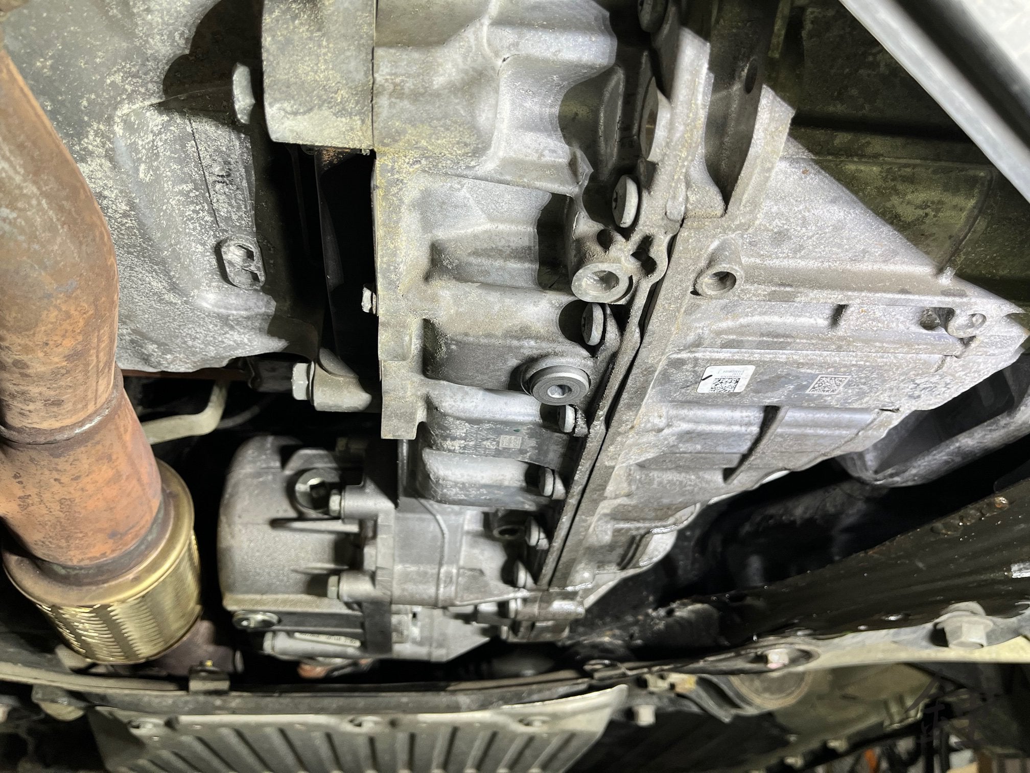

  3. Drain Plug: Loosen this last. Located on the bottom with 8mm hex key. Do not confuse this with the transfer case plugs which are located to the left of the transmission but requires a 3/8" ratchet or breaker bar.

Tools:
