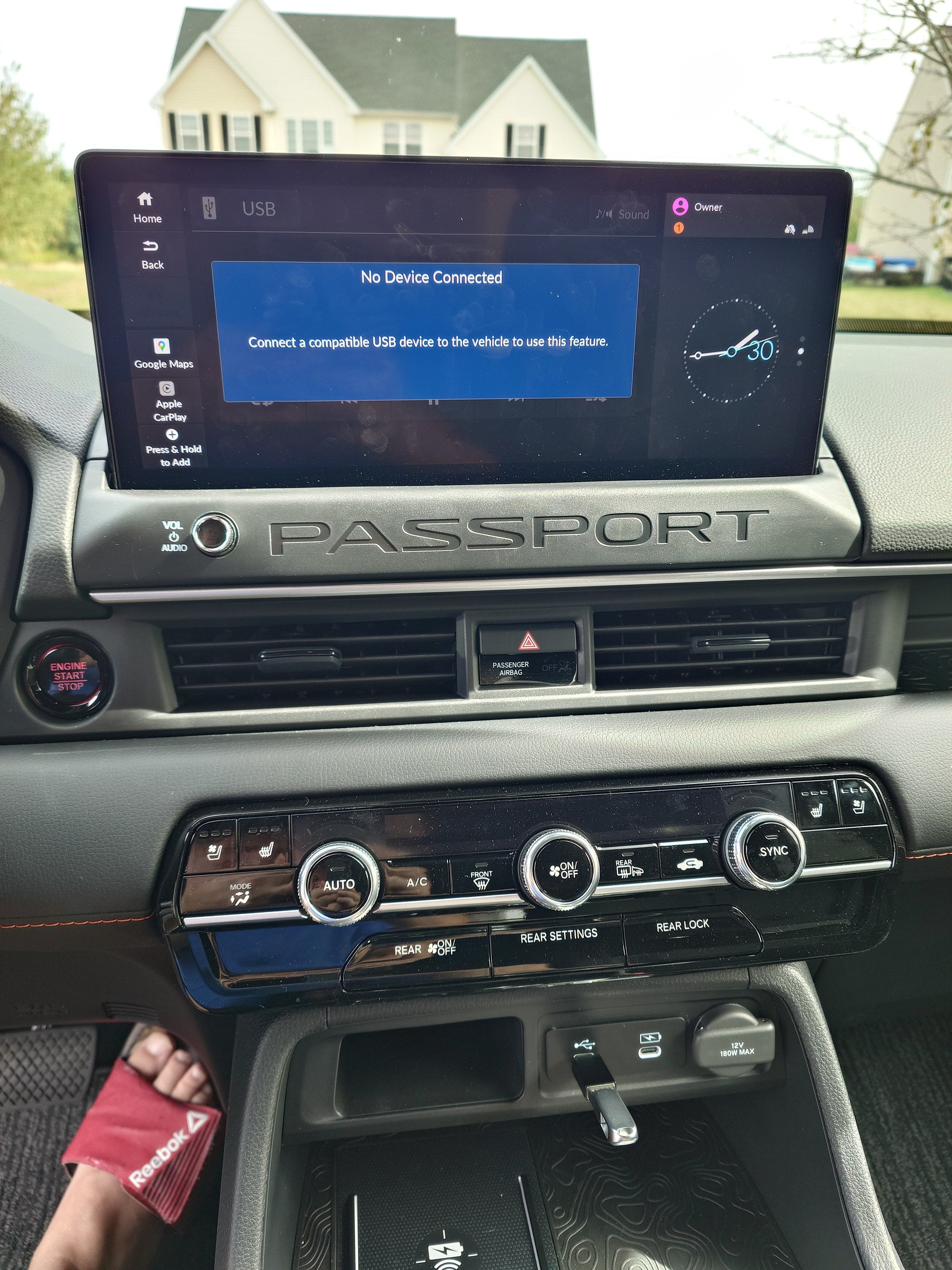

I tried today with a USB-C to A adaptor and still no luck, still says incompatible device.

No joy. Called the dealership and they said to try different USB drives. This is very frustrating. Again USB works fine when I plug it in Passport 2023 or Odyssey 2023.

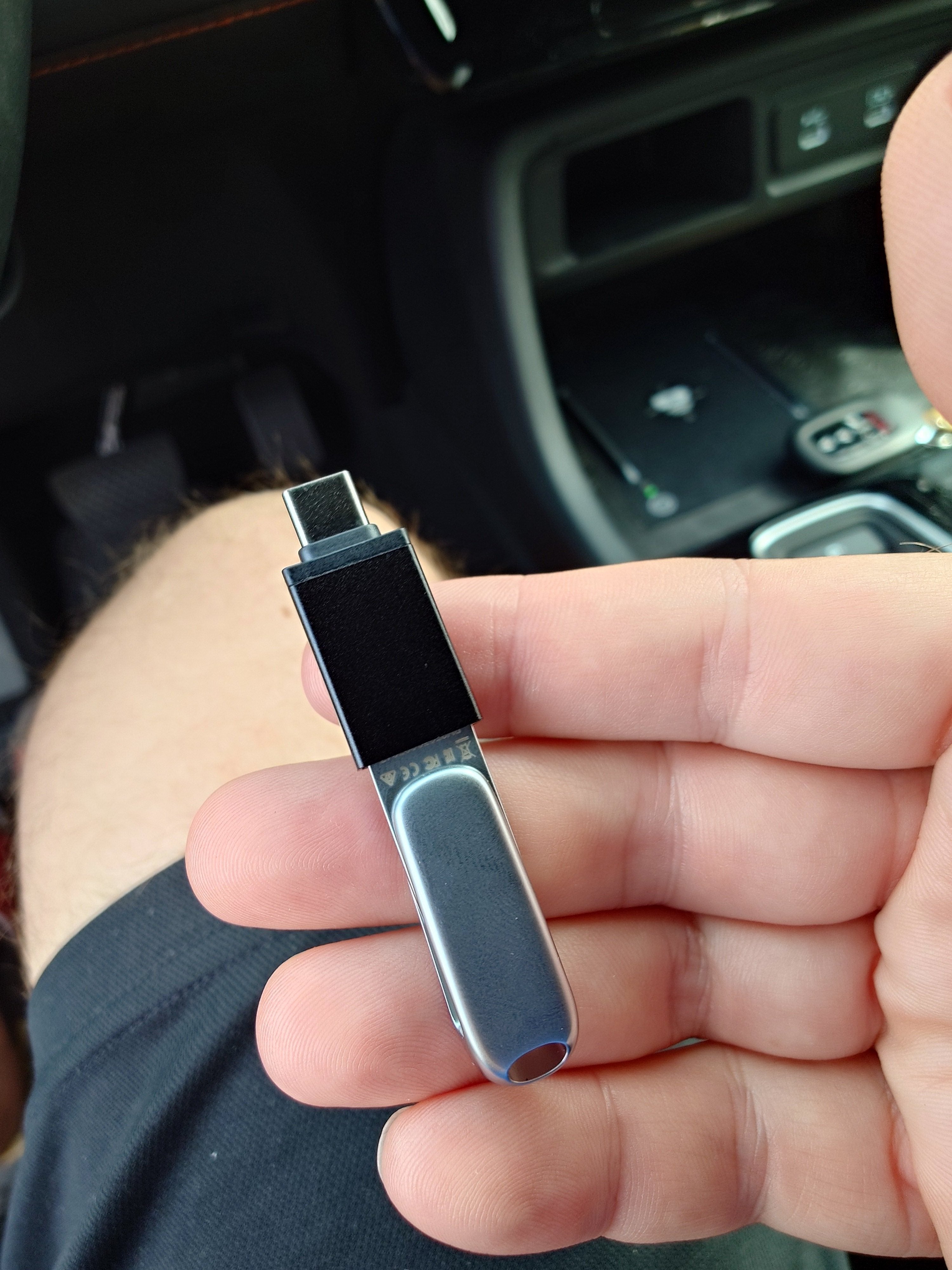

So I received the 90 degree adapter and connected my old SanDisk 64g micro thumb drive (pictured) and it works fine just like the straight adapter I previously tried. I also ordered a new SanDisk 256g micro thumb drive, formatted and installed 1 CD ripped AAC format and got the message "Connect a Compatible USB Device." I'm at a lose...I think fx_chip may be correct with a missing codec issue.

So I received the 90 degree adapter and connected my old SanDisk 64g micro thumb drive (pictured) and it works fine just like the straight adapter I previously tried. I also ordered a new SanDisk 256g micro thumb drive, formatted and installed 1 CD ripped AAC format and got the message "Connect a Contactable USB Device." I'm at a lose...I think fx_chip may be correct with a missing codec issue.

Attached is a photo of the 2 drives that worked with the adapter....I hope this helps!
