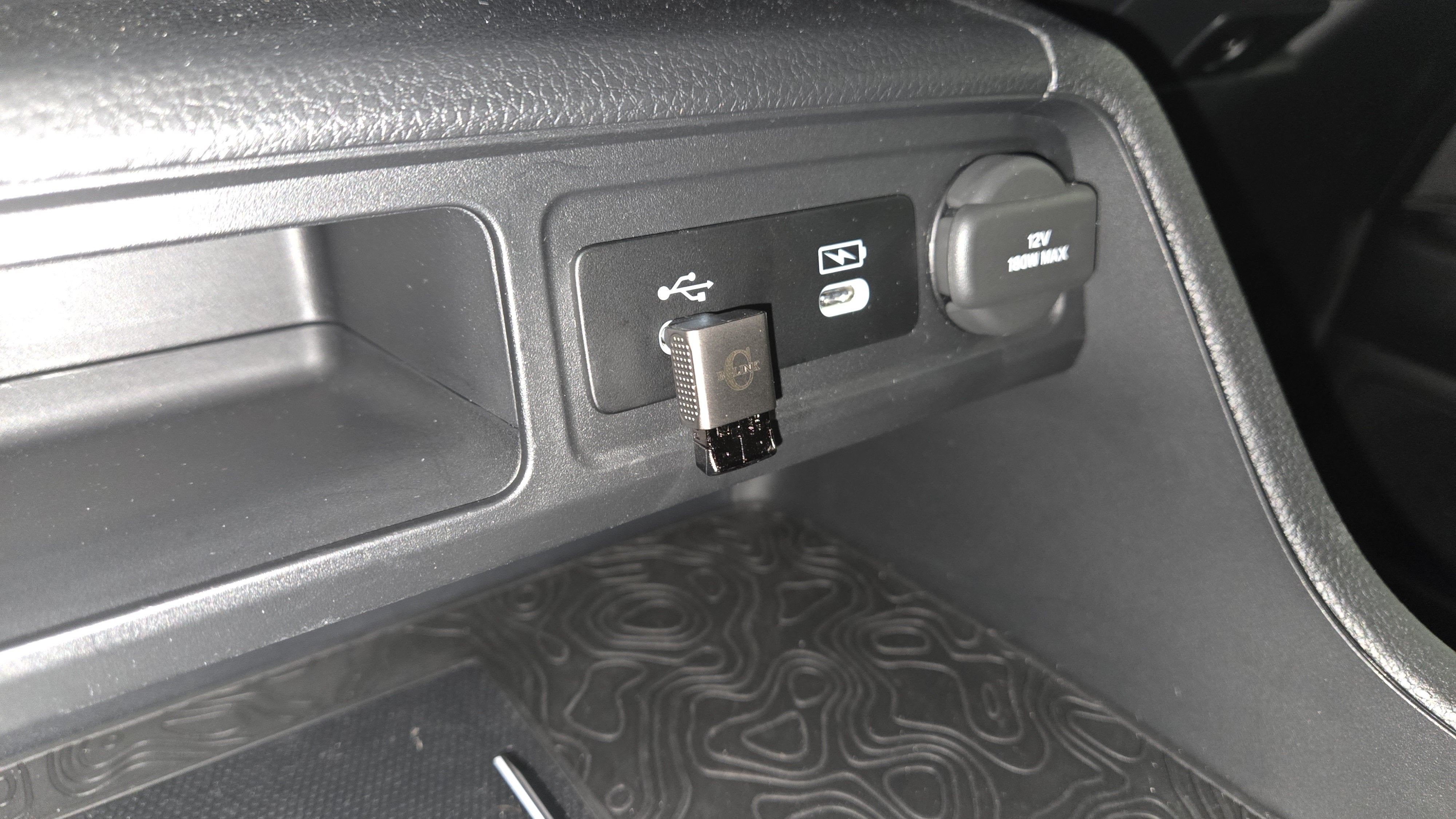

Here's what worked for me, 64g SanDisk micro thumb storage and a Anker adapter. This is the original thumb drive I had in my 2019.

I just ordered this 90 deg adapter to see if I can shorten it up a bit.

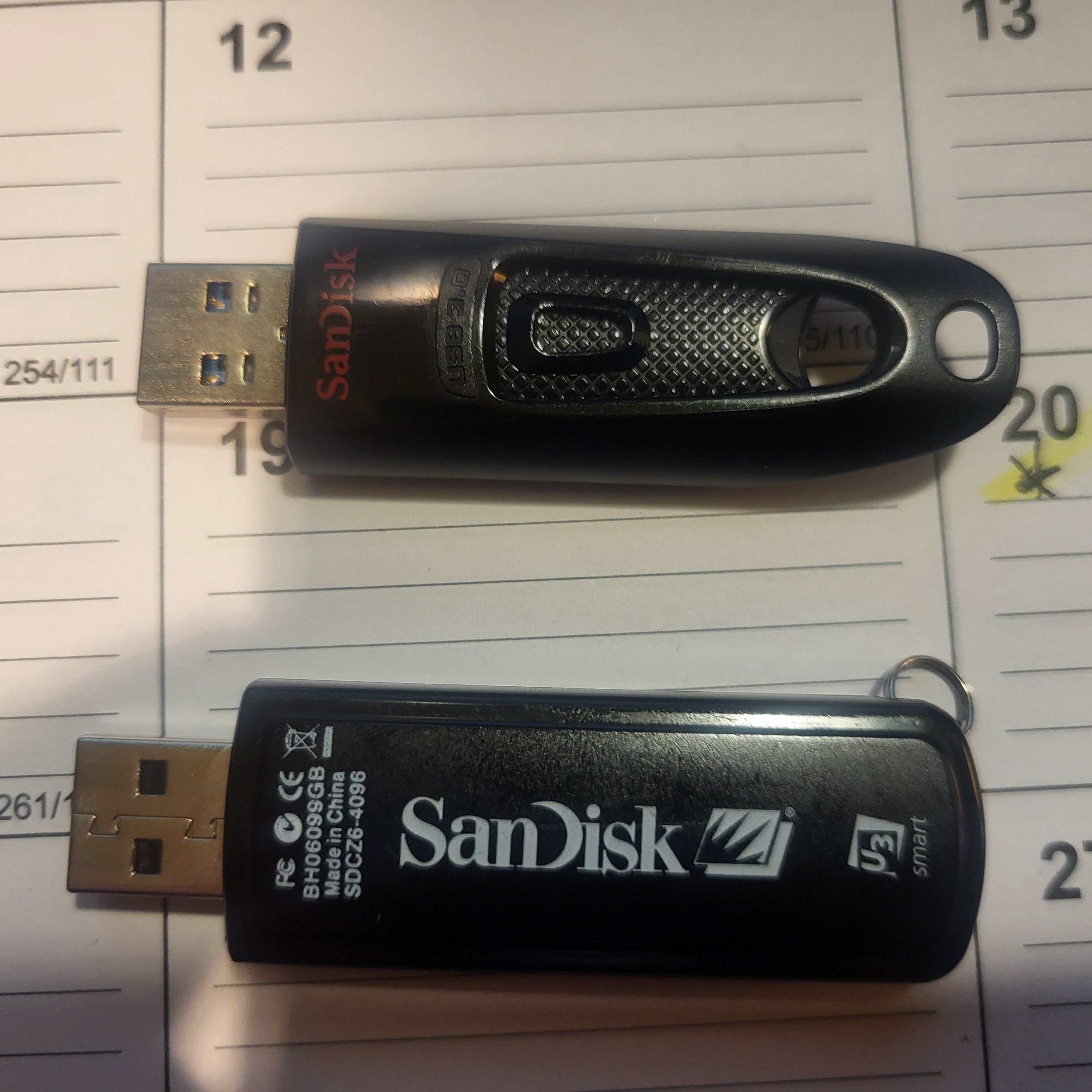

Ok Gang....You know how frustrating this is, but I have some partial results for you, notwithstanding a service appointment for next week. Today I tested five flash drives with music through the adapter I bought yesterday (Insignia). Here are the results:
Sandisk 64G, FAT32 - success!!
PNY 32G, FAT32 - Failed
Make Unknown, NTFS, 16G - Failed
Sandisk Dual Drive Go, FAT32, 256G - Failed (also failed with ex-FAT format)
Sandisk, FAT32, 4G (yes 4G!) - Success
So, it seems to me that random drives will play while some won't be recognized. The drives I succeeded with are older ones and are type A. The dual drive one is brand new and has a type C end but no go.
When I see the Honda people next week I'm sure they'll tell me the same thing (random drives) & I'll tell them that they owe it to people spending 50K+ on their vehicles to inform us as to which drives work, especialyy since they've apparently changed the system. So many of you have never had a problem like this with older Hondas & this is my first.
I'll let you know what happens next week but expect a repeat of the above.

So I received the 90 degree adapter and connected my old SanDisk 64g micro thumb drive (pictured) and it works fine just like the straight adapter I previously tried. I also ordered a new SanDisk 256g micro thumb drive, formatted and installed 1 CD ripped AAC format and got the message "Connect a Compatible USB Device." I'm at a lose...I think fx_chip may be correct with a missing codec issue.

Attached is a photo of the 2 drives that worked with the adapter....I hope this helps!
