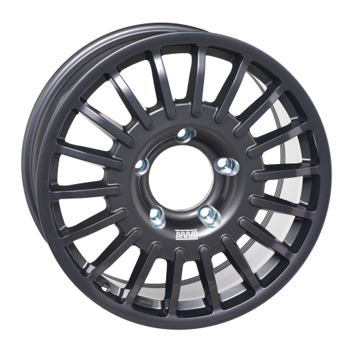

More research has lead me to Braid Wheels. These are the same wheels Honda HPD rally team use on the rally passport. Looks like they make most sizes with custom offsets. I have not really seen anyone on this site with them, the model I like is the "Winrace T". Load rating is 2645 LBS and can be made in any offset from -5 to +52 about. Cost for this model is high at $490/wheel. Colors seem to be limited to white/anthracite/gold depending on model. I wanted to mention these wheels because maybe someone will pull the trigger on them and let us know more about them. I will likely get a set next year.
