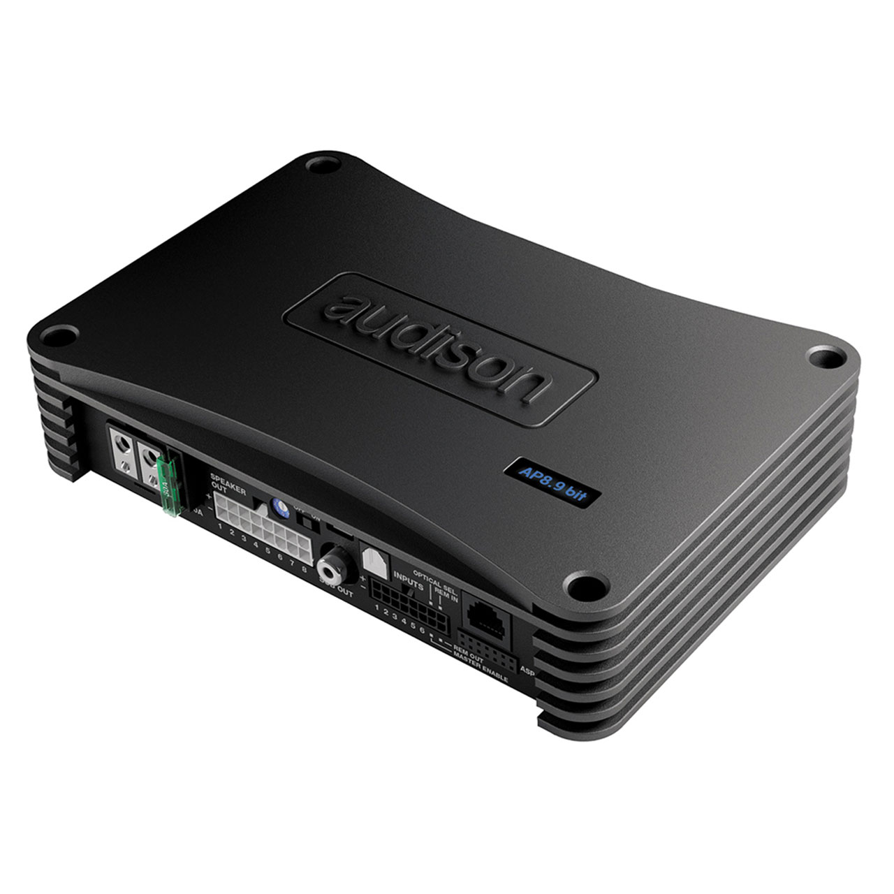

As far as an Amp, I would suggest looking at the Audison AP 8.9 (see link below) : 8 channels, 65wpc @ 2ohms, which will drive your speakers just fine!
I'm thinking an amp for the subwoofer. Subwoofer/amp upgrade project down the road. Will be looking for Sub replacement speaker ( and most likely and amplifier to drive it ) recommendations then. I did look into the AP 8.9, wanted to upgrade but was leaning on keeping the system stock if I could pull it off.
