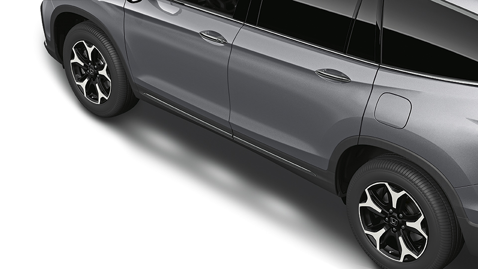

Sorry to dig up an old thread but does anyone know what type of bulb is used? And also how many? My 2021 EX-L only has 2 lights on each side of the car. Some people's car look like they have 3 or 4 lights on each side. I'm trying to change the bulb to a white led color instead of the yellow-ish color

These are yellow-ish LED, three on each side and two for the tailgate. Looks like you have running boards with the lights, so it may be different from the welcome light kits only. The LED units cannot be taken apart to replace just the bulb as far as I can see, in case you'd like to know.
